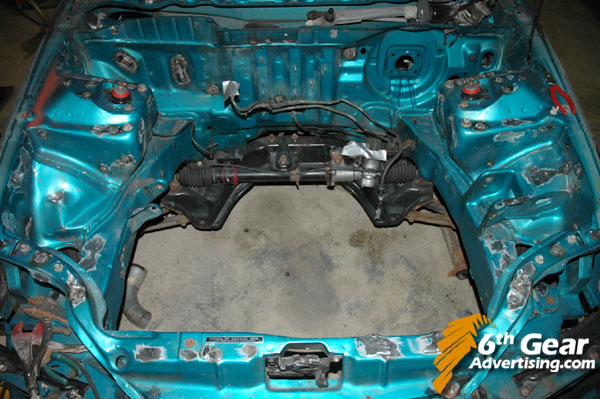

What I've been doing all winter:
I have had my hatch since 2000 and bought it is a DD/winter car so I wouldn't have to drive the Mustang. Well I couldn't just leave it alone, I started with suspension, then intake/header/exhaust, and then a Y8 mini-me swap. Last summer I bought the HX for cheap so that has become my new winter car. I pulled the hatch in the garage thanksgiving last yr and have been working on it on weekends, here's some pics of the progress.
Old motor
bunch of useless clutter left in the bay
here's a pic, had the interior out to convert to manual and for re-routing some of the wiring harness. it was about 0° one night, a good time to remove the sound deadening
a little while later:
And then the wiring:
stock
lengthened
the goal is to re-run the wires for a cleaner engine bay. here the driver side comes out of an existing plugged hole connecting the cabin & inner fenderwell.
The passenger side harness was going to be a pain to remove, so I left it in the car & extended it.
There's also a plugged hole on the right side that connects the cabin to the inner fender area. These wires for the lights/horn/fan will now be hidden.
Car came w/ power steering, but I'm converting to manual. Power racks have a quicker ratio than manual, so converting to manual rather than swapping in a manual rack = teh win

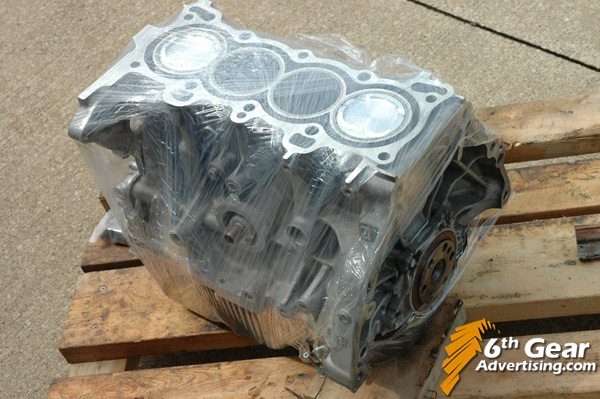

The original plan for winter was just to convert to manual & fix the rust, keeping the Y8 mini-me setup. Bryce gave me his old D16z6 (THANKS again!!) which supplied the tranny. I had the block (which knocked) sitting in the corner of the garage in hopes of tearing it down this summer for a re-build to handle some boost. Well after finding a hell of a deal on the Turbo, I couldn't wait... so that plan is in progress right now.
To better handle the boost

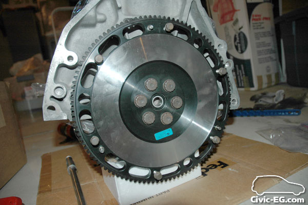

oem clutch won't like that so well so:

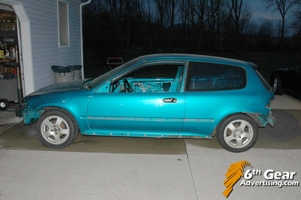

Last weekend was the first time the car moved since Nov,
I'm sure the neighbors love a teal shell sitting in the driveway
The only additions to this bay will be a motor/tranny, radiator, brake booster/cyl, clutch cyl, and lines and external coil.
No more battery, wires, PS, washer resivior, fuse box, coolant overflow, charcoal canister, fuel filter, brake proportioning valve. all that stuff is either in a cardboard box or relocated somewhere on the car.
After 500 mi with this setup, I'm gonna install the turbo and all the clutter that comes along with it (catch can, vac lines, oil lines, IC, piping)
I'll post the finished car, hoping to have it on the road in a month, after body work & paint job.
The reason I did all this? the 96-98 gt 4.6 isnt the best base for a performance motor b/c of the restrictive heads. Supercharge would cost $3500 and decrease my 1/4 mi by about a second. So why not put that money into a car which has potential to run the same 1/4 mi AND kick ass in the twisties, while getting 30-40 mpg when not being beaten on. And have 2 nice cars, instead of a nice V8 and a deteriorating hatch.
So I'll finally be able to bring my Civic to a CSi meet instead of my Ford

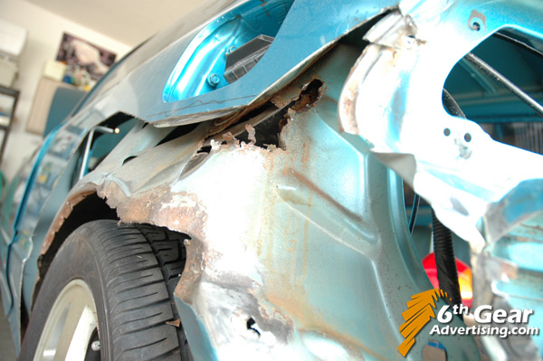

The surgery has begun!!
first I drew a template and cut just inside the line (not enough is safer than too much)
next had to use a wire wheel on a drill to scrape off all of the panel bond, then was able to find the spot welds and drill every one of them out
Pryed it apart with a mallet & a flathead screwdriver, only to find more spot welds to drill out...
Finally drilled them all and was able to pull the panel out.
Looking into the top of the wheel well, you can see the black adhesive strip that Honda used on the seam to prevent rust from starting.
guess it didn't work as well as they thought
drilled the rest of the spot welds out from the fender lip and got the panel off.
damn... gonna have to do some fabricating here, but it doesnt need to look pretty since it won't be seen.
the spotwelds in the wheel well, and the ones that were rusted away near the top.
Inside of the oem panel
Now I know why the body shop told me $3500 If I wasn't this far along and didn't install urethane bushings I'd sell this one and look for a rust-free hatch. If you're ever looking at buying a rust free civic, be sure to take out the interior panel and have a look from the inside. Check where the fender meets the bumper and where the fender meets the rocker panel. That's where it eats from the inside out. 5-6 years ago I had one tiny bubble in the paint on the pass side and the driver side looked perfect lol. There will definitely be no more winters after this!

Bryce, it would have been 100x easier for me to just buy another hatch. I was only doing this because I had replaced all the bushings w/ urethane ones, but even doing that again would be way easier and quicker than doing this body work, as I am finding out
Oh well I started so I might as well finish!
the rocker panels were rotted
the inside was only surface rust though. Just the part where the side skirts attached were rusted through.

welded in. Welding beads look pretty, but to keep the metal from warping from heat you have to tack, then tack in between those tacks, then tack in between those etc... so that leaves you with alot of extra grinding to do afterwards.
Started shaving the engine bay...
Every hole is grinded to remove the paint, then welded in.
then those welds are ground down flush with the sheetmetal and uneven areas are welded more and ground down more. repeat process
battery, fusebox, and cruise control holes are too big, need to cut out a piece of sheet metal for these.
just remember which ones you need to keep
ran out of argon so called it a day for welding. that is all for this week of project teal the block should be back from the machine shop soon

pass side rocker was swiss cheese dammit
nice pile of rust in my car
the carcass
oh thats shitty
almost as shitty as drilling out spot welds
I'll get back to this in a bit...

rear quarter and rocker panel in
it's starting to look like a shell again
AND....
back from Michael's
leaving it wrapped up untill the body is done... gonna wait till it is in to put the top end on so I won't have to lift the car up so high again to put it in through the bottom.
that's all for now, I'm seeing it done in Aug sometime I hope.

some motor pics:
xtd 6-puck stage 3 clutch + 8lb flywheel
motor going back together
painted the front graphite to keep it looking nice and clean
OEM headgasket FTW
cleaned up the head. stock valves, runners & combustion chambers have been smoothed.
back together

last time I posted it looked like this:
then it needed smoothed...
relocated some crap: coolant overflow & battery tray
then there wan LOTS of sanding...
and primer...
and paint!
Yep teal is no more... I went with my first instinct (green) when I saw how much oem paint would have hurt the wallet. So now I have to do door jambs, but no biggie. The heat lamp makes the green look more yellowish than it actually is.
more shaved bay pics:
all is left for the bay is the motor + radiator install everything else is relocated or in the junk pile.
